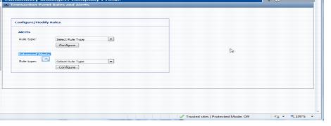

In the Mailbox Specific Alerts section, enter the following information.
a
From the Rule type drop-down list, select Arrival Alerts.
b
From the Mailbox drop-down list, select the mailbox to which this rule should apply, then click Configure.
3
Click Add Arrival Alert
Click Actions > Add Rule.
