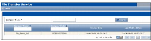

Click Select Company.
4
If you see the partner company in the list, click its link in the Company Name column to go to the selected list page for the partner.
For a long list, type the first few characters the partner name in the Company Name field, then an asterisk (*), then click Search. Then, in the Company Name column click the link of the partner you want to view.
